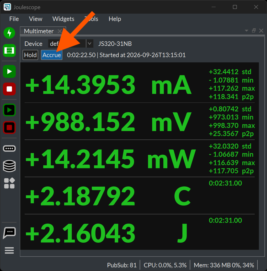

If you want a single number from live-streaming data, then you can use the multimeter widget. Press the Accrue button to start:
The current will be the average current since you first pressed Accrue.

It works pretty well, I did notice that resetting “accrue” doesn’t reset Joules or Charge
Right. Today, you use Tools → Clear Accumulators to reset the Charge and Energy accumulators.
With the Multimeter Accrue feature, there are two right answers. Do not affect accumulators or set accumulators to zero at the start of an Accrue. A long time ago, I implemented the former because it was easier, and no one has said anything since.
Would having an option to zero accumulators at the start of an accrue be useful to you? At the end of the accrue, it would go back to the “normal”, unaffected accumulator values. The downside is if anyone issues a Tools → Clear Accumulators during Accrue, the accumulator values will be completely wrong.
