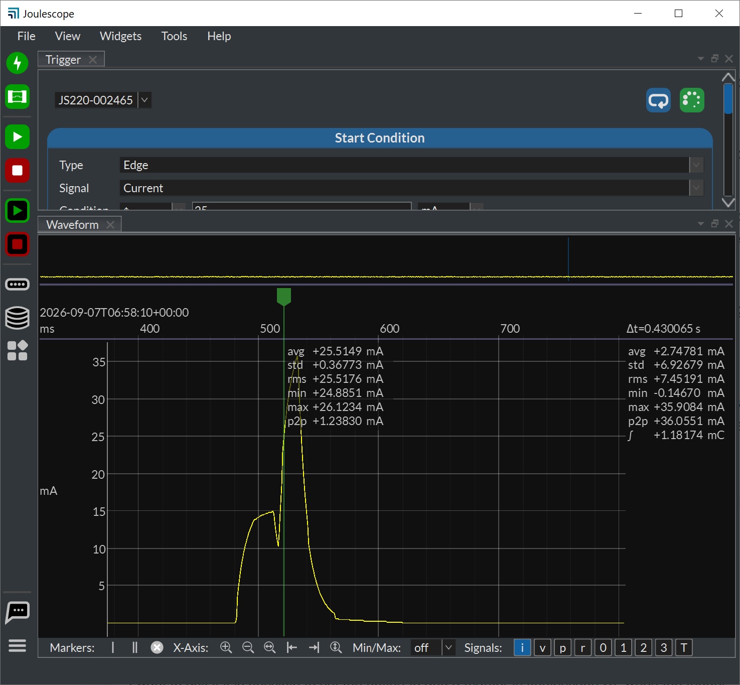

I want to ask if it is possible to set the option to add a marker in Joulescope UI, when the trigger function is enabled, but without its statistics? I only want to find the position in the waveform where the event occurred. I don’t need to see the value data. Displaying informations cause higher CPU loads.

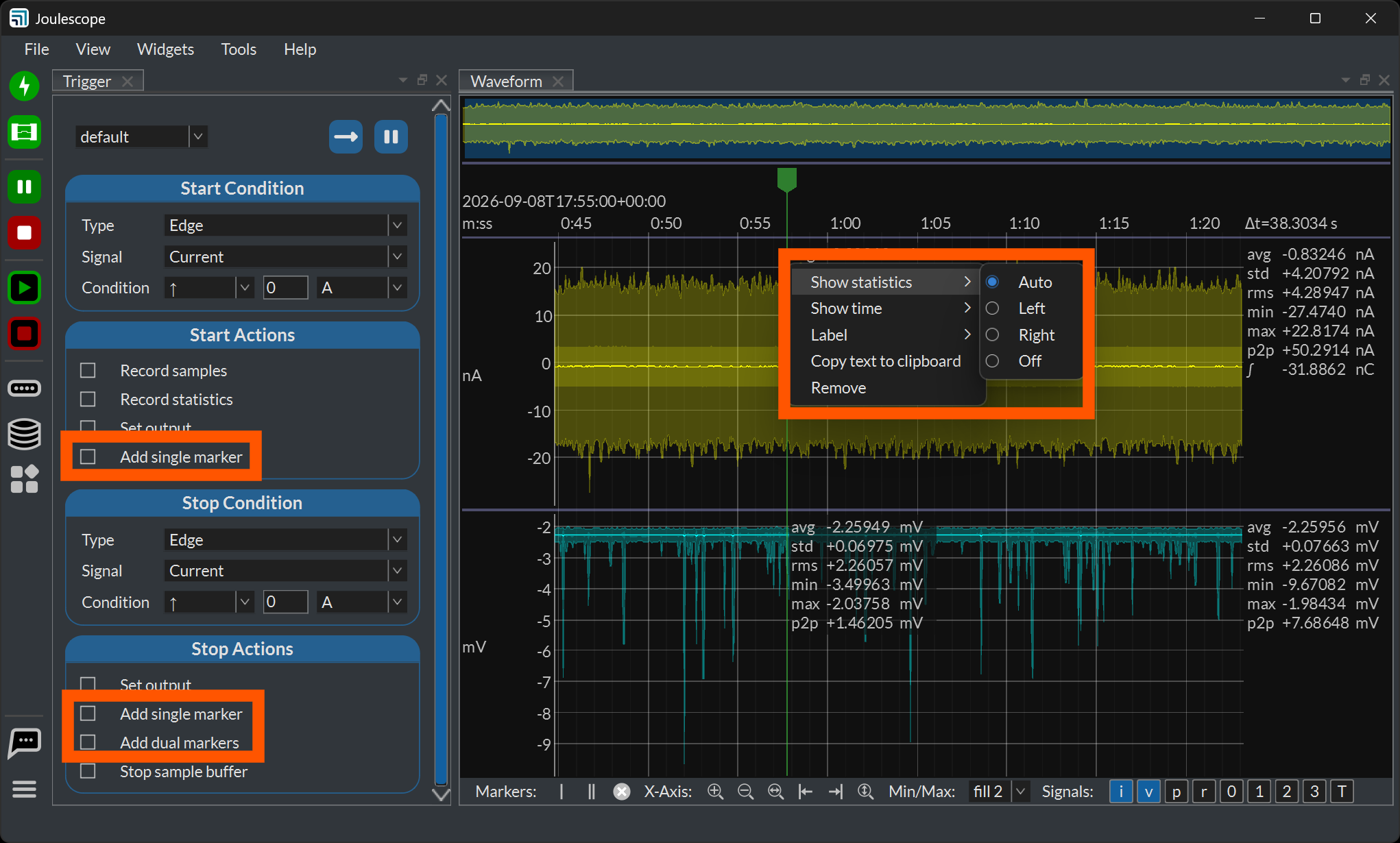

Hi @janav and welcome to the Joulescope forum! As of Joulescope UI 1.7.0, the Trigger widget allows you to add single and dual markers, but it has no options for configuring those markers.
In the Waveform widget, single markers have options accessible by right-clicking:
We could potentially refactor this to make this right-click menu available in the Trigger widget. Any changes to the defaults would get applied to all new markers created by that one Trigger widget.
Is this what you have in mind?
