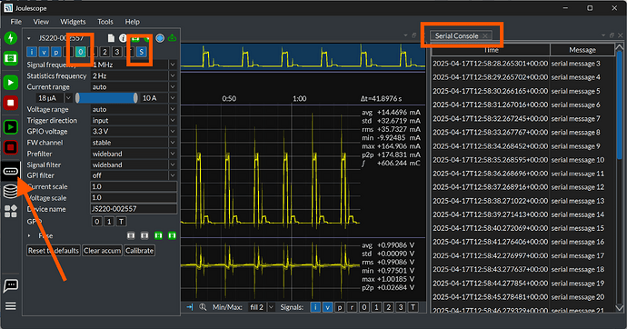

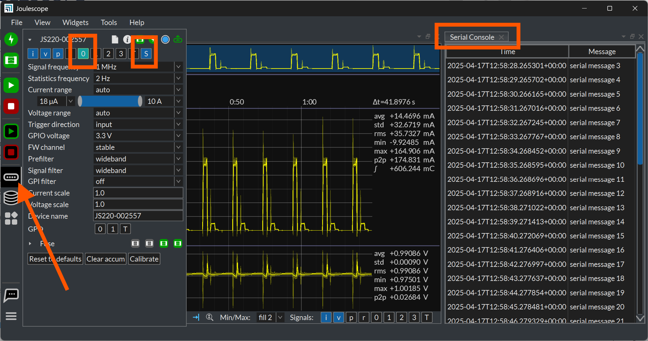

We added serial decoder support for the JS220. If you have a JS220, you can configure serial decode first selecting View → Oscilloscope. Click the Device Control widget icon from the sidebar and enable signal 0 and S. Select Widgets → Serial Console and postiion the widget as desired:
You can then click on a message in the Serial Console widget, and the widget will a single marker to the onscreen Waveform widget at the corresponding time.
This serial decoder feature provides very minimal functionality as of April 2025. No configuration options exist at this time. The serial link must be 115200,N,8,1 and must be connect to GPI 0. Performance may also be an issue, especially if the target produces lots of messages within the buffer window duration. Decoding is only supported on live data, no JLS support.
