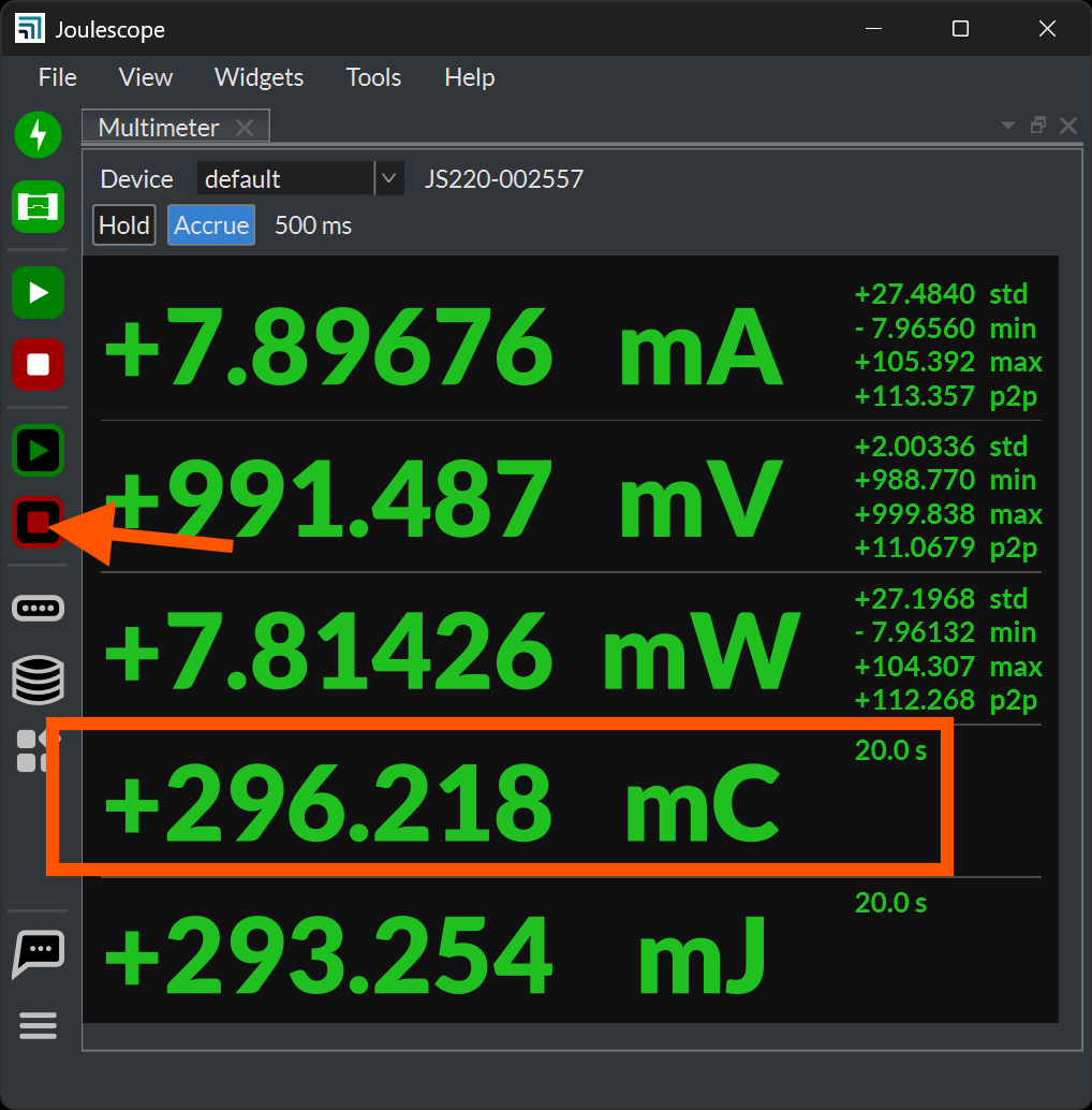

Hi @isaac and welcome to the Joulescope forum!
Yes, the Joulescope was designed to accurately measure these currents and integrate to compute charge (and energy). If you only want to see the total, you can use the Multimeter view, like this:
You can also record these same statistics over time to a CSV file by pushing the button indicated with an arrow. You can also downsample, say to 1 kHz, and record to our proprietary but open source JLS file format for later viewing in the Joulescope UI.
Yes, all the Joulescope hardware and software performs proper integration. The instrument is full 4 quadrant, ± current, ± voltage.

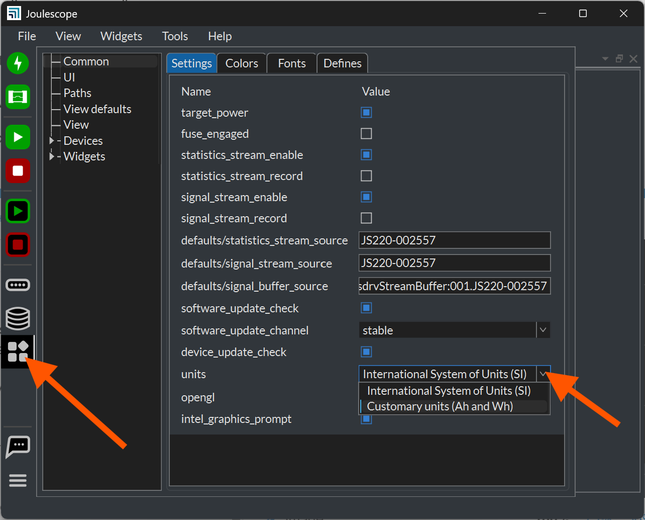

The Joulescope UI uses SI units by default, but you can select customary units like this:
