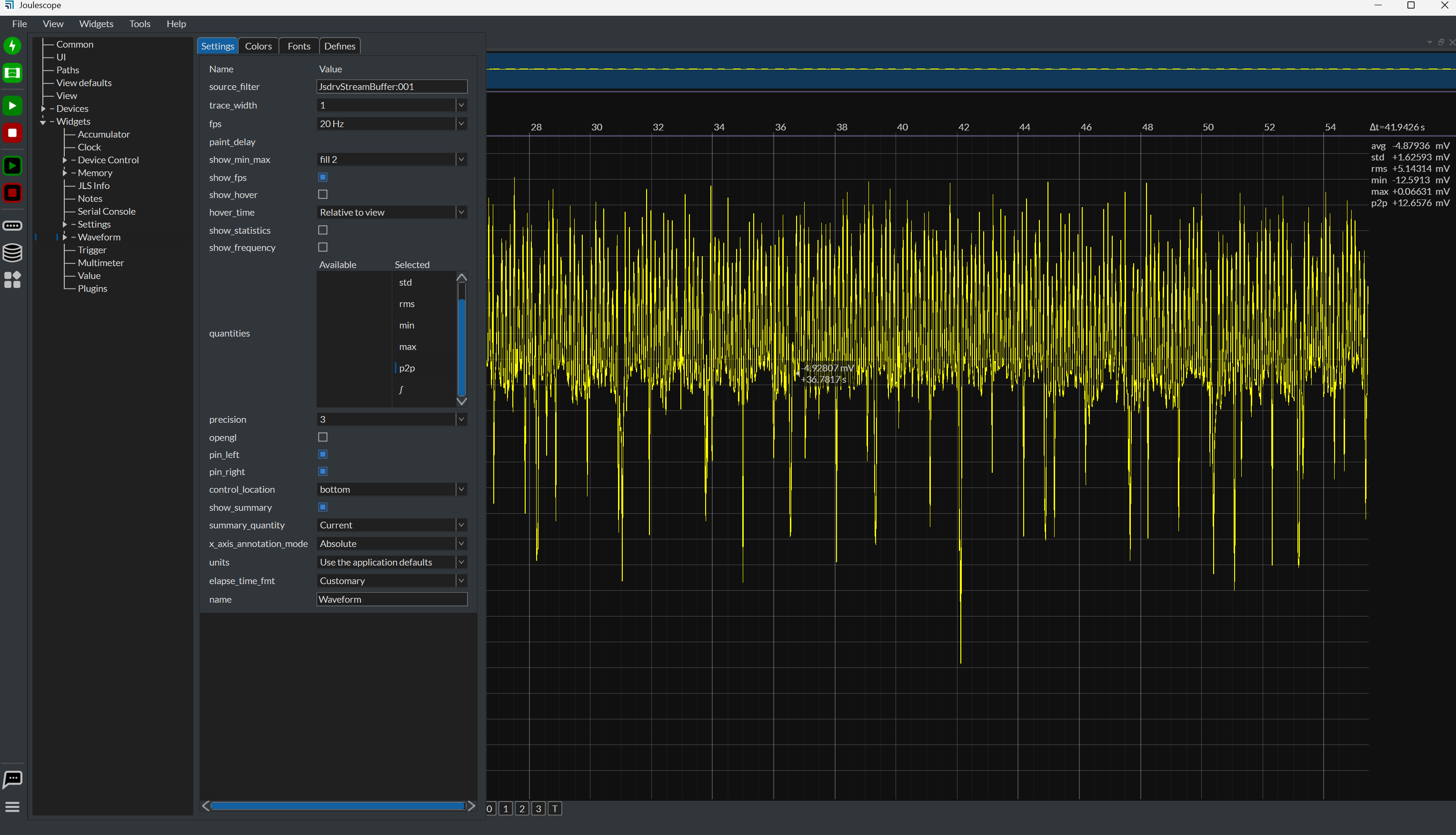

I’m having the issue of the lagging on the UI, there is a post (Laggy display of Waveform view) where the user disabled OpenGL to solve it, so I tried to do that but seems like the settings are not working.
Here I’m setting to not showing statistics and it is still showing, before I also tried to lower the precision and also nothing changed.

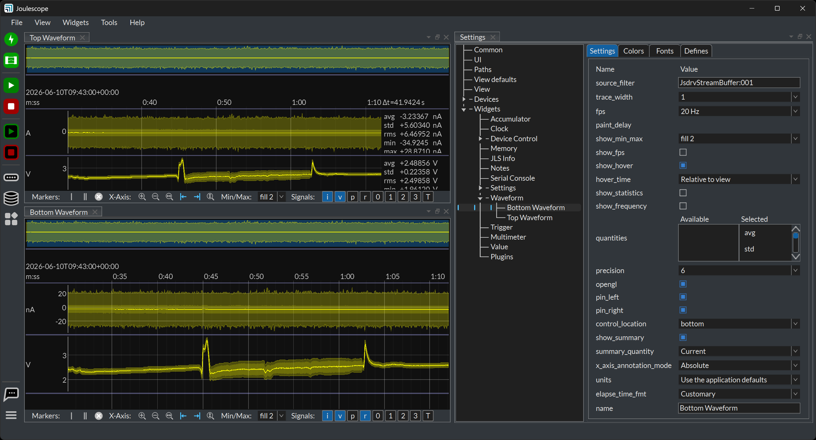

Settings can get confusing. You are editing the default Waveform widget settings, which will apply to newly created Waveform widgets. If you want to edit the current Waveform widget settings, you have to expand that section and click on the active Waveform widget.
Here is an example where I created two Waveform widgets and used the name field in settings to rename then and then disable show_statistics on the bottom:
In general, it’s easier to right-click on the Waveform widget and select Settings, which always brings up the settings for that widget.

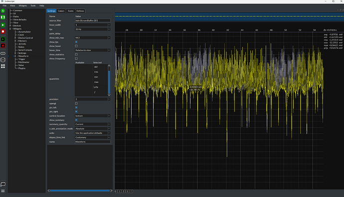

Hi! thanks for your quick reply, that worked.
Unfortunately the lag problem persist. When I launch the UI the data flow smoothly, I activated the show_fps option and it goes 20fps… for a while. After some time (10min or so) the fps rate begins to get lower and lower until it reach 1fps or lower. At this point the UI is completely unusable and even closing it takes a while.
I recorded a screen capture videos to show the problem, but I cannot upload them to this interface, it says: “Sorry, new users can not upload attachments.”
I already cleared the config, installed other versions (now I have the 1.5.1), tried deactivating opengl in the settings but nothing seems to help.

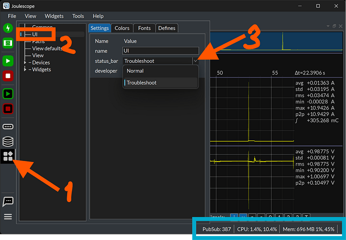

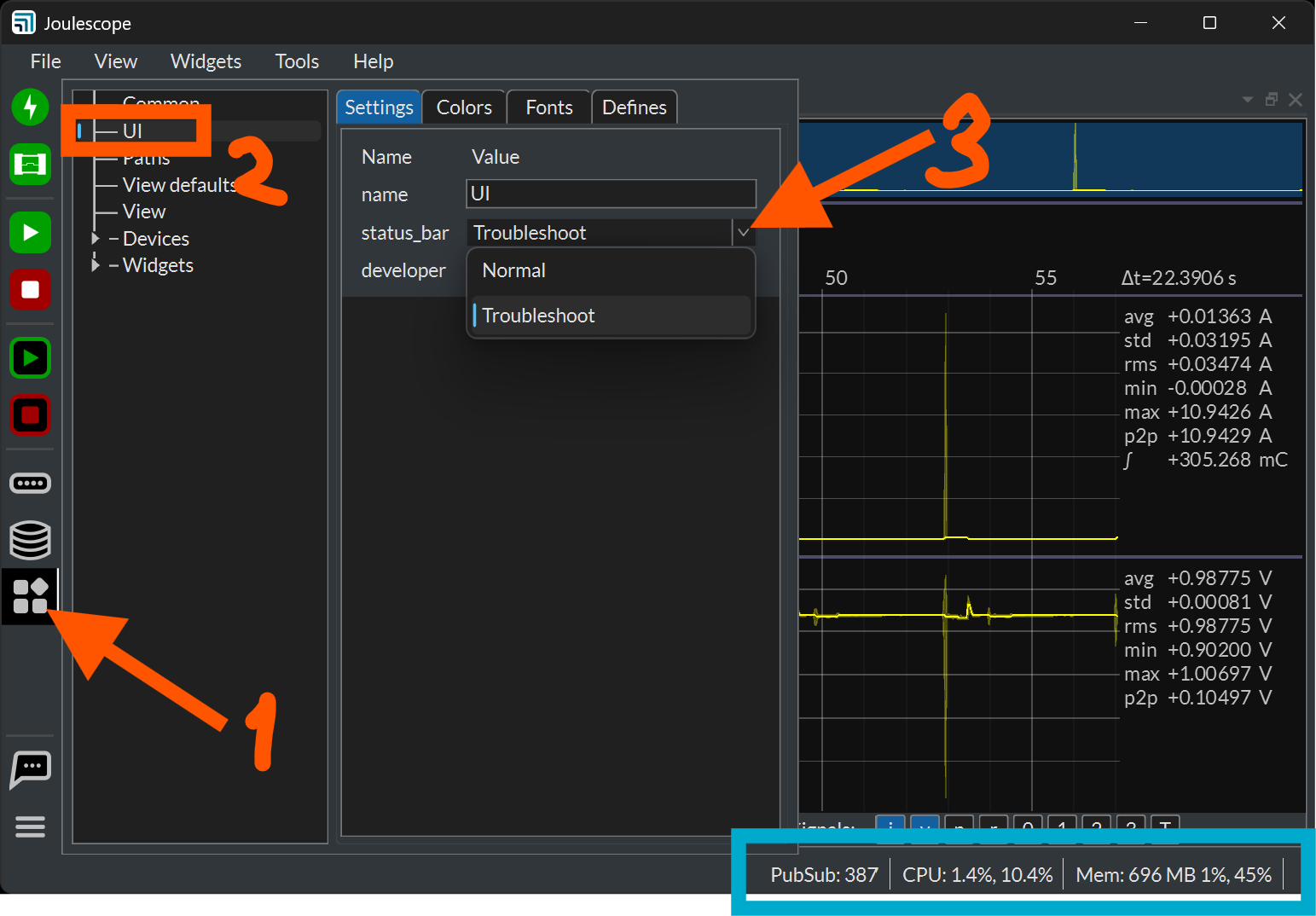

  1. Configure Troubleshooting for the Joulescope UI and watch what happens over time to the resources shown on the status bar:
