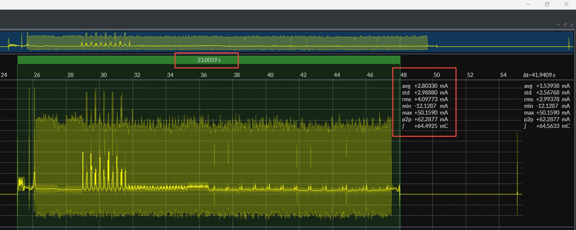

Thank you for your quick reply!
We are trying to communicate with Joulescope UI via python because we need to do a lot of sample tests and record values and graphs, but it seems that it’s not possible?
Also, when I right-click, I see different options than you do, so how do I fix that? Any assistance would be appreciated.

The Joulescope UI displays context sensitive menus when you right click. In order to see the context menu in my screen capture above, you have to right click on one of the the dual marker edges. Does this make sense and work for you?
